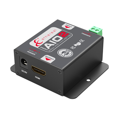

I've had success in several client systems by adding this Ethereal HDM-AI02, but not sure if it will solve your problems. Unfortunately the only way to know for sure with any of these devices is to try it. I'm sure your dealer has access to these as well. The link has a lot of info, and some discussion videos, so you can decide if it's worth a try.
I have an extremely complicated video chain (nothing I would ever sell to a client) and the AIO solved my problems. I'm actually having to use the relay controlled Hot Plug Swap terminals as well.
Very interesting, Jim. If the AVProEdge splitter doesn't get me going, I'll have to consider this. I'll be learning about it regardless, as it does look like an interesting tool!
