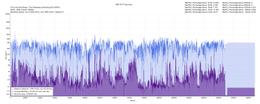

mmmm The over-cropping that was supposed to be fixed in the latest firmware update is not fixed at all. The player(or their encoding) still over-crops everything to 2.40... What the hell???
Example, The Lord of the Rings: The Fellowship of the Ring 2001
UHD-BD top = 275 / Bottom = 276 (2.38)
Kscape Top = 280 / Bottom = 280 (2.40)
- over-cropped
- Slightly lower quality
. UHD-BD has better grain retention and better fine details
UHD-BD
- over-cropped
It wasn't fixed in this firmware. Remember he said it would be a two part fix but that would mean something with raised blacks and I said that would cause problems with video processors so he said they would likely just wait and do it the right way but that would be spring.
