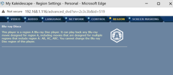

Something isn't adding up. If you have a region A and region B player in your Premiere system then you should be able to play any disc that is recognized as region A or B. If the disc in question truly is recognized as region B, I'd expect it to be playable in either player (assuming the disc is inserted). Are you sure the disc is recognized as Region B?
For reference, you can read how K describes Blu-ray playback behavior here.

Does it have a region A or question mark (?) in the region code info of the movie details in the web interface?
If it does have an A and not AB and it's actually a B it wont play. If it has a ? and is a B it won't play.
I encounter this issue from time to time with discs and I have just mailed movies@kaleidescsape.com and they update with the correct info without sending the disc. But it could be that I only had the ? on these cases. It's about 30 discs that I mailed them about.

I have a region A player
And a region B player

It must have been identified as the US release. If you mail them the EAN/UPC for the UK version and say to them it's Region B locked it should sort it out.
