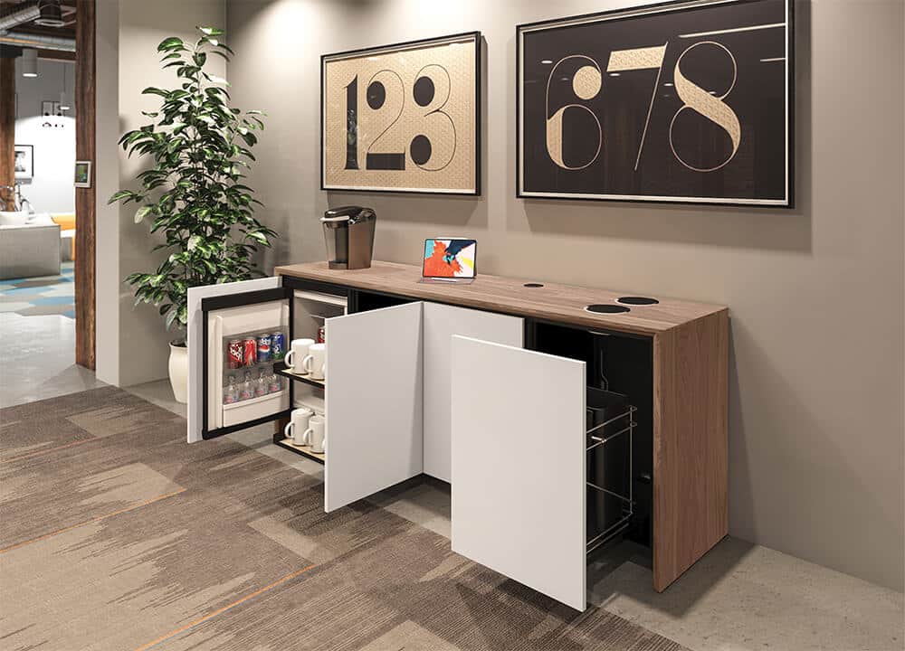

With several of my components (including my Strato S) going inside a bar-height cabinet, I had a desire to get a rack that would allow easy access to my gear after it was installed. I ended up going with a Mid. Atlantic similar to this that has worked really well.
Here are a couple shots of the installed rack in varying states of swivel.
